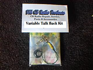

Do you want variable talk back in that thing?

150 ohm resistor to the ground of the external speaker jack solder it to ground of the chassis, if you want on-off, put a spst sub-mini inline, if you want variable, I can do that too

In the TR 467, The speaker is already grounded, it isn't a floating ground. running a resisitor to chassis ground will do nothing in this specific radio.
