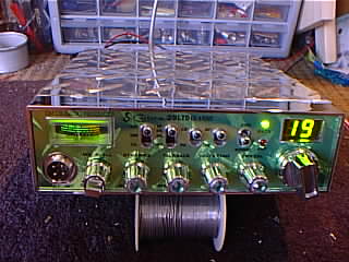

- Cobra 29 LTD Classic
Key-Down Competition Unit
Custom Built By:
Dodgem - 250
DM CB Radio Products
Indian Head, Maryland - cobra29green.JPG (22.99 KiB) Viewed 58647 times
