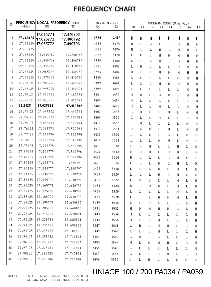

Don't know if this is of any use to you Norm, this is for the ISS3 LC1 board
Dave.How far is it.
Re: JD Custom LC2 (iss1) Eprom conversion - TC9119
Thanks Dave i'll Check those against my eprom board to see if its getting the correct inputs. (assuming that / is high and blank is low).
if the eprom is getting the correct inputs but incorrect outputs, can i assume that the eprom is bad?
Norm
Yes Norm,
High is / and blank is low. Don't forget they are different boards, mine is the ISS3 and uses a 2732 EPROM not the 2764,
having said that the switch codes to the EPROM input pins should be the same, they can't change.
I can offer to read your EPROM for you so you'll have the program that's in it.
The chart above is what Rick sent me some time ago and there are different versions of the conversion as Rick will tel you.

I'll try to load another chart I have to see if that's any better. The chart below is the original channel switch codes using the standard factory fitted PLL.
Don't bother looking for a truth chart for any other radio that uses the 145106 PLL, it won't help you, It'll just make matters worse.
The channel switch codes used for the TC 9??? PLL's are not in any specific order that makes sense, as you can see in the list above, there all over the place.
- Frequency_Chart.png (146.09 KiB) Viewed 86626 times

There are 2 ways of working out the DATA codes needed.
Method 1: use a couple of hex thumbwheels:
Set the thumbwheels to the halfway mark (80), Radio should lock OK. Write down frequency.
Set it to 81 and measure again. It should have moved by 5 or 10 Khz. This is your step.
You can now make a chart from 00 to FF showing all 256 combinations, by simple derivation.
For example, if 80 gave 27.305 and 81 gave 27.315, it follows that 82 must be 27.325 and 83 gives 27.335, and so on.
Method 2: use good old mathematics
Example: Radio uses 10Khz reference and a 15.360 downmix. Calculate code for FCC channel 40 RX (27.405 Mhz):
VCO = RF - IF, so VCO = 27.405-10.695 which is 16.71 Mhz.
Fin = VCO - Downmix, so Fin = 16.71 - 15.36 = 1.35 Mhz.
The next step requires Khz, not Mhz, so multiply by 1000 to get Khz: 1.35 x 1000 = a value of 1350 Khz for Fin.
NCode = Fin / Ref. 1350 divided by 10 = 135.
135 is the decimal value, NOT the hex value our EPROM programmer wants.
Use the Windows calculator accessory (change it from Standard to Scientific view) to convert:
135 decimal = 87 hex. Therefore we program 87 into the EPROM to hit 27.405 at the address combination we wand to make the radio go to 27.405.
For example, 86 should give 27.395 and 85 should give 27.385, and so on.
Because the reference and downmix cannot be easily determined in many cases, I prefer method 1.
I keep a pair of thumbwheels soldered to the data pins of a 28 pin EPROM socket to do this. Total cost was under $20.
Hope I explained it clearly enough

No, as this can change for different radio designs.The output data in theory could be found by using a truth chart for the MC145106 PLL chip
Old school PLLs like the MC145106 were not fast enough to directly control the VCO frequency, so downmixing had to be used so that the thing could work.
Code: Select all
RF mixers 101:
When 2 frequencies are combined at a non-linear junction (i.e. a diode or transistor) the result is FOUR frequencies - the original 2, the "sum" (both added), and the "difference" (the highest one minus the lowest one).
For example, mixing a 20 Mhz signal and a 25 Mhz signal results in a 5 Mhz signal (25-20) and a 45 Mhz signal (20 + 25) being created.
A filter of some sort always follows a mixer, to remove the unwanted signals.
For example, if we only wanted to keep the 5 Mhz one, a 10Mhz low pass filter would allow it to pass but block out the 20, 25 , and 45 Mhz ones.
In this case, it is called "downmixing" because we have created a new lower frequency that is relative to the ones that created it.
If our 25 Mhz signal drops by 0.1 Mhz to 24.9, then our output will also drop by the same amount (in this case, to 4.9 Mhz).
Most 27 meg radios use an IF of 10.695 Mhz, which needs an oscillator of 27 megs - 10.695 (for RX, to keep it simple, TX is a bit different)
To receive FCC channel 40 you need a 16.71 Mhz oscillator (27.405 - 10.695).
16.71 is more than the 4 Mhz the MC145106 can handle, see a problem?
A downmixer is used (the EPROM board uses 15.360) to overcome this.
The 3 transistors and the associated components are the downmixer.
The 10.24 is halved then tripled which gives 15.360 Mhz. This is then downmixed with 16.71 to give 1.35 Mhz which our PLL can handle.
Note that the PLL never "sees" the 16.71 Mhz directly.
Therefore, there can be no standard "truth chart for the MC145106 PLL chip".
But a lot more educational to learn how to do it yourselfit would be a lot easier to buy a new eprom board
I''d be buying a couple of hex switches and wiring them to the data lines and working out the codes for myself...
